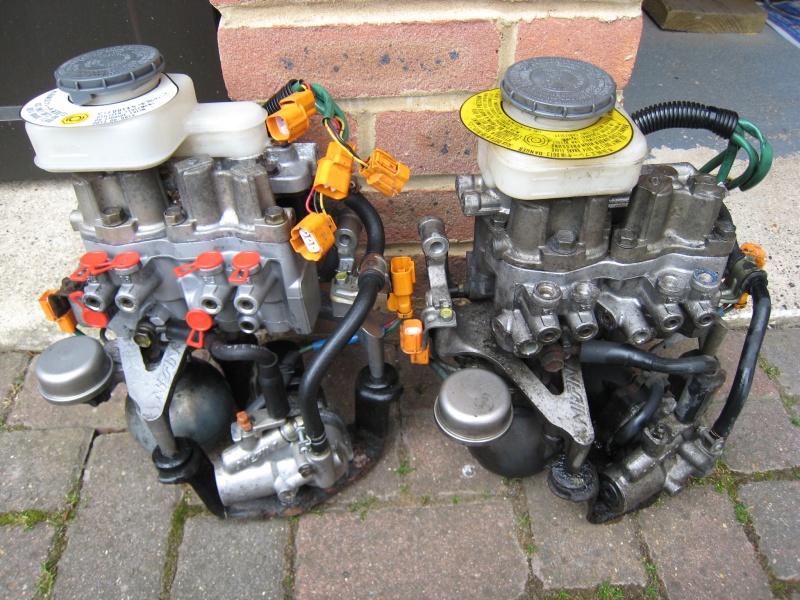

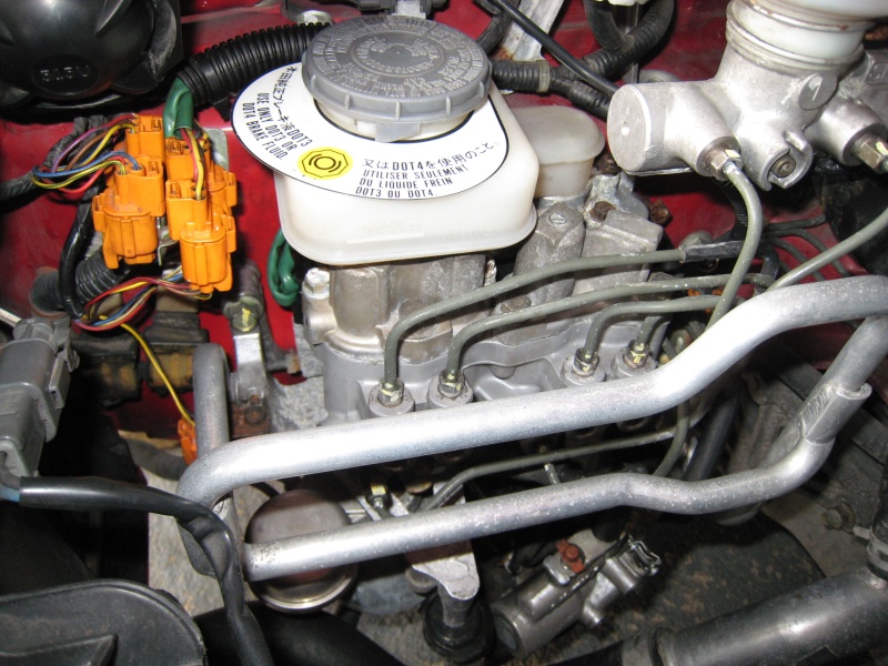

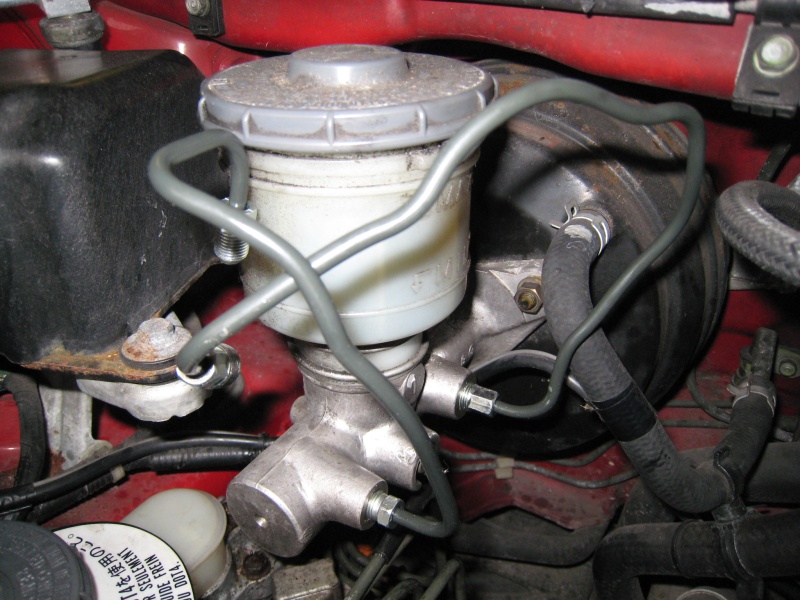

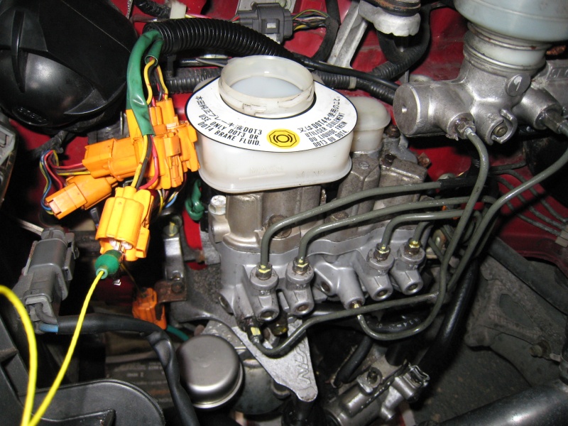

On our NSX, the ABS has been upgraded in 3 stages since its introduction to the world.
Attachment 7437 Attachment 7438 Attachment 7439
Original version (1st photo)
The original ABS was used up until some point 91 - 92 on UK model with the VIN up to ***0T100325.
2nd stage (2nd photo)
The original ABS showed several issues including sticky solenoids and Honda changed the modulator design and upgraded it (2nd stage) from UK model VIN ***0T100326.

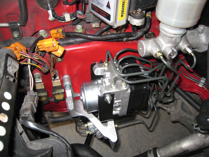

3rd stage (latest spec) (3rd photo)
Introduced all new design ABS (3rd and final stage) with one box solution in 99.
[Edit: additional info here; http://www.nsxcb.co.uk/showthread.php?10434-ALB-ABS-generations]
Even with the 2nd stage upgraded ABS, there are some issues reported but most of them happened with the original design.
Ultimately, it is best to upgrade it to the final spec as the modulator and controller box are combined into one box and also it is integrated into the main brake system using the same brake fluid from the brake master cyl reservoir.
The reaction time and control of latest ABS are far better than the predecessors.
The original and 2nd stage ABS were separated from the main brake system and thus, they had their own reservoir for the ABS.
The problem with the design of these ABS was that it showed several issues with the sticky solenoids, leaky accumulator, slow response time, dull control and somewhat caused dangerous situation when the accumulator lost pressure resulting in no ABS while the pump was trying to build up enough pressure.
Some owners reported as if the pedal went to the floor due to the lack of kick back at the pedal while the pump was making that famous squeaking noise.
Having said this, the cost involved in upgrading the ABS to the latest spec would be difficult to justify for some of the owners unless you drive your NSX regularly or you can treat the upgrade as insurance.
I upgraded mine to the latest spec because I drive my NSX everyday even in the wet and winter. Also, for me, it is insurance to have the better chance of stopping the NSX under panic situation before hitting something. The repair would easily exceed the cost for upgrading the ABS to the latest spec.

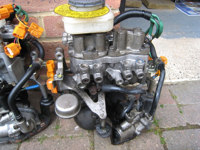

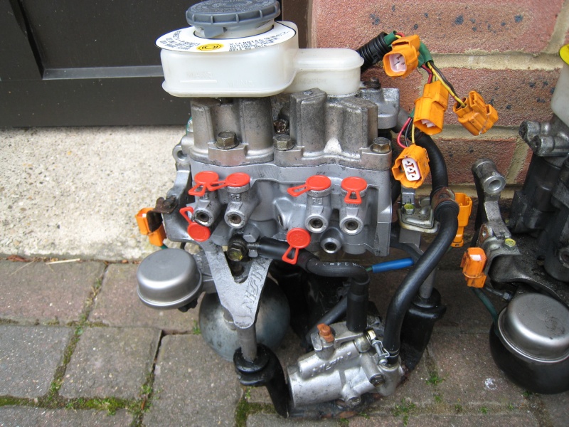

One of the owner contacted me a while ago as he wanted to replace his original design ABS to the 2nd stage one that came out from my NSX.
His ABS was initially recovered by flushing the system and all four solenoids but eventually, the same issue came back and the pump started to kick in every 5sec. The typical sticky solenoids and/or leakage at the accumulator.
The owner simply removed the pump relay as the noise was annoying.
Attachment 7440
I checked his VIN and since the controller box was the same as mine, I was comfortable to use my used ABS into his NSX.

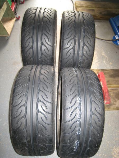

Yokohama Advan Neova AD-08
Finally, I got my new tyres.
Thank you to some of the members here for their feedback/review/advice on selecting the tyres.
I used Goodyear F1 GSD3 for many sets/years but since the introduction of their F1 Asymmetric, it was not easy to source GSD3s so it was time to search for the new tyres.
Initially, I was looking at Hankook K110 V12 Evo and Yokohama Neova AD-08 but both of them were out of stock at that time.
As I use OEM 16/17 wheels, I preferred AD-08 because Hankook doesn’t come in OEM 215 size for the Front.
It was the same for GY GSD3 so for quite a while, I had to run 205 instead of 215 at the Front.
For AD-08, even it is made in Japan and it was already released last year there, it was still very expensive and thus, no cost saving in importing it.
Same result for importing it from US and thus, it was best to buy it in UK.
After long-long waiting time, finally I had a phone call from Yokohama UK and being told that AD-08 for the Front are going to be available during the first week of August.
So, phoned up the tyre company and reserved all four tyres.
I was very lucky because I think I booked the last two remaining stock for the rear tyre size for the AD-08. The next delivery will be towards the end of the month.
Attachment 7460
So, new tyres fitted.
As I always use the same person to mount the tyre, I can say that the side wall stiffness is harder than the GSD3 but not quite as the OEM NSX ones.
When AD-08 was released last year in Japan, I was worried about the wet traction due to the aggressive tread pattern but lots of NSX owners including my friends were surprisingly happy with the wet performance so I can’t wait to drive my NSX in the rain.
My NSX is everyday car so wet performance is quite important here in UK.
I even drive in cold winter and even took my NSX out in the snow during last winter when we had ‘heavy’ snow (for me, snow where I live in UK is nothing) so interesting to see how it performs under cold condition.
Too early to comment anything at this stage as the front tyre size changed compared last set, only covered little mileage, still playing with the tyre pressure and so on.
Will try to provide some feedback in the future.
